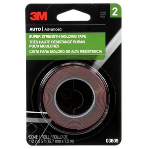

This stuff (1/2" wide) is $7.49 at the Fargo Chief Auto Parts.  You can get 7/8" wide for $10.49.  Likely similar prices at any auto parts store:

I don't recall packaging in Canada with Spanish. Now English, French, and Spanish on everything ?

Canadians have this awesome thing called the interweb, with which we can retrieve information from pretty much anywhere in the world! I used it to learn about an auto parts store in 97BLKVALK's area, and the store provided me with a picture of the product they sell. Why they have English and French on something sold in the US when Spanish would be sufficient is a mystery to me.  angel

« Reply #23 on: March 14, 2018, 06:24:32 AM »
There's your VHB. Shelf life will deter initial stickiness, but warm the surface before you apply it and it will restore the adhesion. I buy it from sign suppliers in large rolls, when using fresh stock, you better place it where you mean to the first time.
