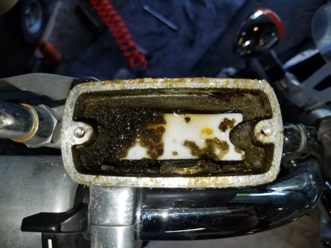

Next I decided to have a look at the front master cylinder with the thought of flushing the front brake system.  Below is what I found when I took off the cover.  Obviously it's going to be more than a flush.
This is what I dug out and what it looked like after the digging.
I decided the master and both calipers need rebuilt.  The reason for the decision for the master is obvious.  When I was trying to push the bike in the driveway I was pretty sure the front brakes were partially locked so I pulled them off the rotors and was able, with difficulty to move the bike.  I suspect the rear caliper is also partially frozen as well.  Is there a vendor that stands out for parts for our Valkyries?  If I can find rebuild kits I'd do that.  I've already noted that the boot on the brake lever is shredded so I will need that as a start.
I guess another question is whether anyone knows of a good indie for Hondas in/near Daytona Beach?

« Reply #27 on: January 03, 2021, 06:27:10 PM »
I think you should seriously consider buying cheap calipers and
master cylinders from some parted-out ebay bike and rebuild
them with Honda parts...

Man, that's uuugggly.
Mike suggestion is valid, but I'd only swap out the masters with new/used ones and check them.  Possibly, they won't need rebuilding.  Can be had relatively cheap.  Yours are a good bet they will need complete rebuild and kits are $40.00 from Honda OEM.
If you get new/used calipers, most likely your going to want to rebuild with new parts anyways and used are going around $50.00 each.  Your calipers should clean up good.   Put the $ into new seals, cylinders, rubber parts and pads.
Of course, that's assuming you can get the cylinders out. Roll Eyes
Looks like you got some work ahead of you, I'm jealous and am looking forward to the project.

Well, Timbo I think I've got you beat on the schmutz in the reservoir.
Yep that looks bad for sure.  I don't have a goto place for parts specifically.  I usually get them on ebay or amazon.  Every time I tried calling the stealers they would have to order and were more expensive than what it cost me to just order online myself.  I am fortunate that there's a local guy here that does a lot of work on Valks that's I've picked up a few parts from here and there and at the same time was able to pick his brain. Smiley  He has adds running on the forum banners and his name is Bob (AKA - Attic Rat.)  Look for that banner and if you cant find a part he may have it.
RustyValkry

I didn't mention in my previous post that I also pulled the cover and cap off the rear reservoir.  Fluid was very dark but there wasn't schmutz visible though once I siphon the fluid out I who knows what surprise I might find.
I'm also contemplating a switch to Dot 5 if I'm going to do a complete rebuild of the brake system.

What's the clutch master look like?

ICK!!!   Those master cylinders are ugly.
Do you have access to an "Ultrasonic" cleaner?   Those work GREAT for parts like that........and also carburetors.
Just be sure NOT to use a cleaning solution that conflicts with aluminum parts.    They will be clean, but will come out a dark gray in color......... Embarrassed
I wish I had an ultrasonic cleaner, for this bike a sand blaster would be nice too but I'll have to settle for the slow way.
I used a Harbor Freight ultrasonic cleaner with Krud Kutter Parts Washer and it worked great.  No oxidation or discoloration of aluminum or anything of the like.  The one I have is small and can only do 2 carbs at a time and not quite cover the tops so had to turn over after a cycle.  I think I got it for around $70 on sale.
This is the one I have but you can get larger ones elseshere.
https://www.harborfreight.com/25-liter-ultrasonic-cleaner-63256.html

Today I removed the rear master and both front calipers.  The biggest problem I'm going to have on this project is getting steel bolts out of aluminum.  I had problems with the pad pins in both front calipers and the mounting pivot on the front master cylinder.
Next I have to get the rear caliper off.  Do I understand correctly that you have to remove the rear axle to get the rear caliper off?  The caliper can't be detatched from the caliper bracket?
