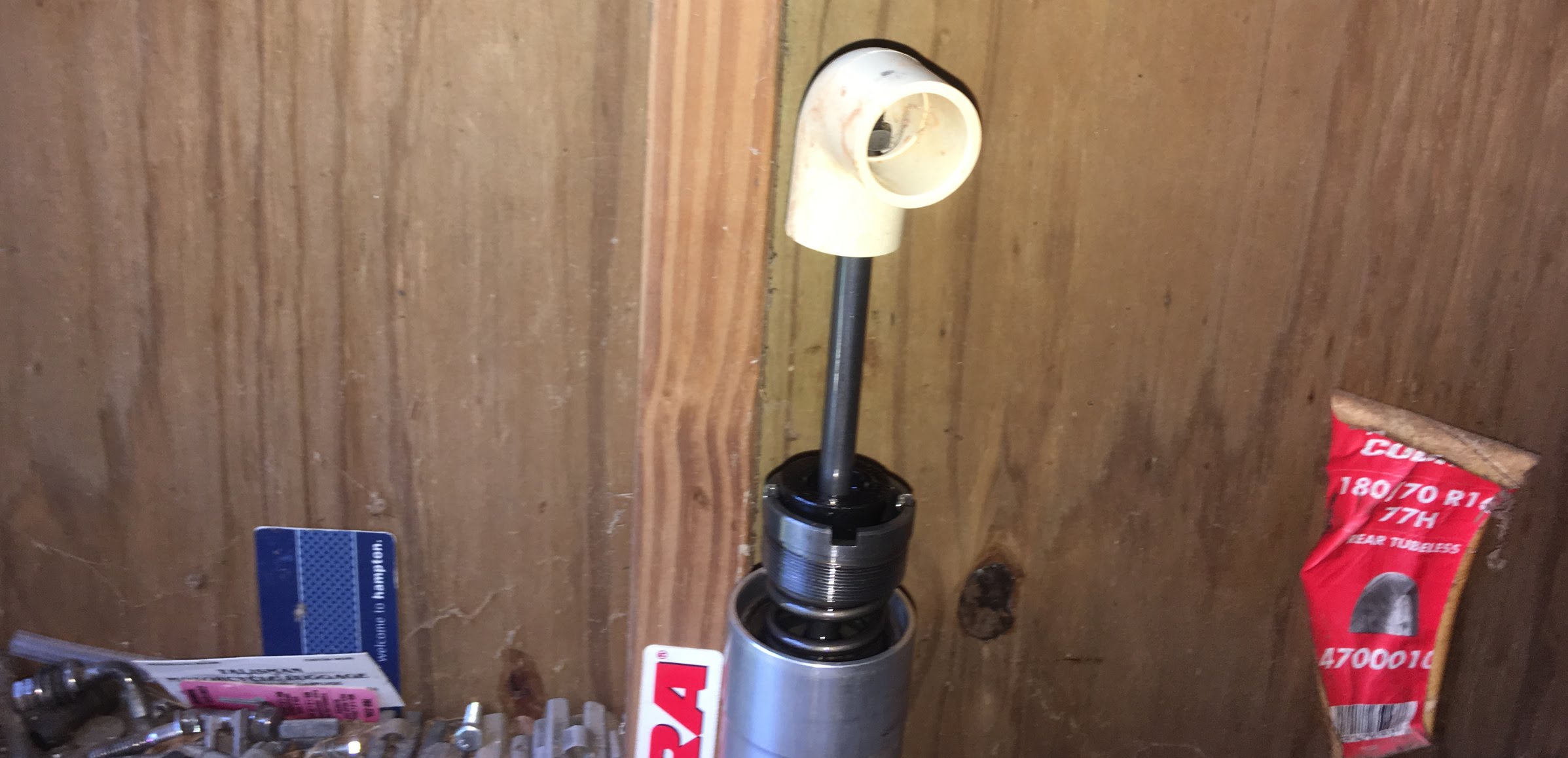

I know I definitely need either the Honda tool or to make my own tool for the castle nut in the left tube and a way to seat the fork seal which there are a few without buying the specific tool for that. Are there any other specialized tools needed? I thought I had read something about a tool needed to push down on the spring while turning the nut but don't see anything about it in the service manual.

Mashing down on this rod to overcome the spring pressure so that you can
hand-start and run a few threads around on the castle nut is unpleasant.
I think of this plumbing elbow as a special tool...

u can make your own fork tool from heater element wrench home depot see my posts.
http://www.valkyrieforum.com/bbs/index.php/topic,70292.0.html
and make a stem nut tool
http://www.valkyrieforum.com/bbs/index.php/topic,31752.0.html

Ohh okay so thats why the Honda tool is so long! I understand now.

Thanks! I have been going back and forth with making my own, I work full time and have limited time to work on the valk and have a bunch of stuff I want to get done so deciding whether to buy a tool or spend the time making one becomes a factor.

Unless you're swapping springs, not necessary to completely disassemble. The following is a good read to help you out.
http://www.valkyrieforum.com/bbs/index.php/topic,124686.0.html
