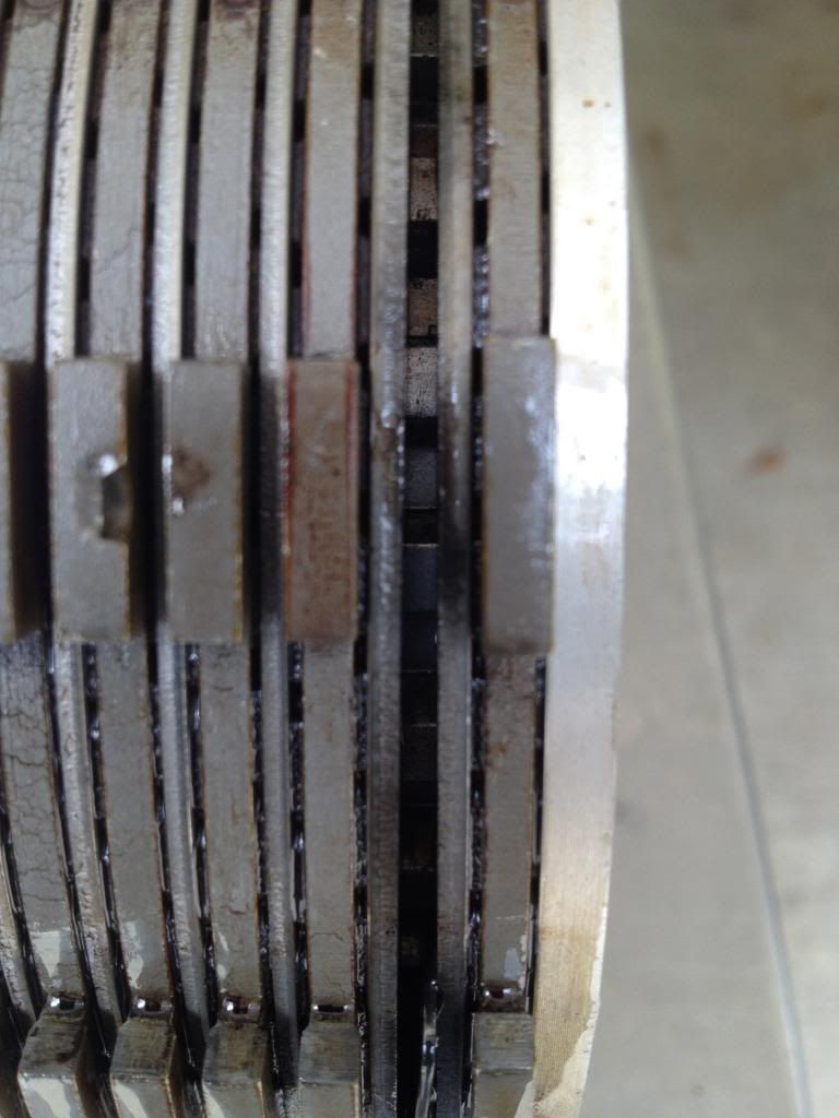

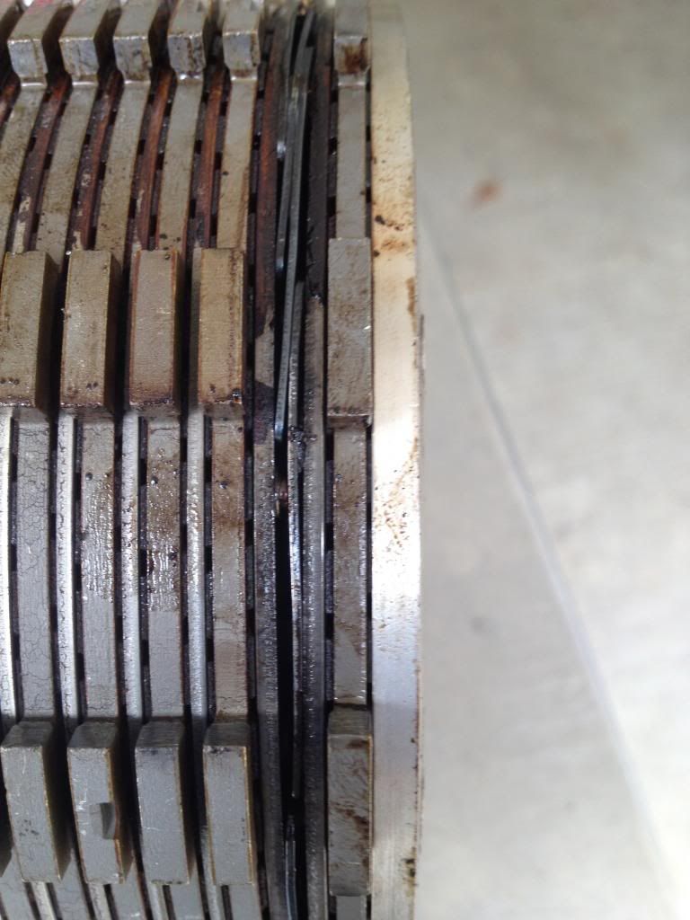

Ok I pulled out the clutch to day and this is what I found
« Reply #30 on: February 25, 2014, 01:13:18 PM »
From what it looks like in the fuzzy picture, you have some rivets floating around.
Time for a clutch rebuild.

« Reply #31 on: February 25, 2014, 01:22:54 PM »
Yes sir that's what that was. Took the pic's with my phone.

« Reply #37 on: February 26, 2014, 05:05:19 PM »
Thanks for the post of pictures, I've always wondered what it looked like with regards to the rivets going bad.
Looks like the rivets wore away, and the clutch pads themselves shifted and jammed together in what ever space they had between the metal plates. No wonder the clutch doesn't move any more, releasing.
