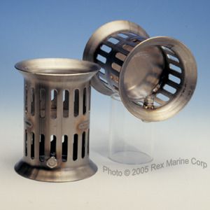

Rex Marine baffles in the exhaust tips or truck stacks is another option.
http://www.valkyrieforum.com/bbs/index.php/topic,56618.0.html
I have been trying to get a set of these but have been told by Rex Marine that they are not making them now and did not know when they would begin making them again.  I have his site bookmarked and check periodically.  Just looked and saw they are are currently "out of stock."
Cpperformance.com has them.  Search "exhaust silencer".
Thanks Davit--ordered a set today.
