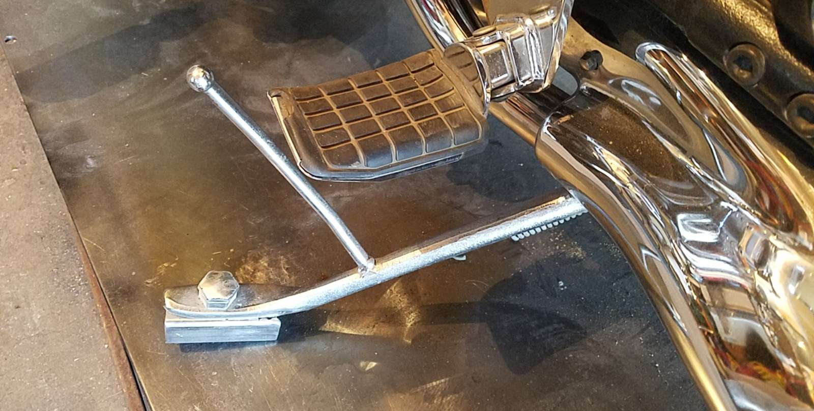

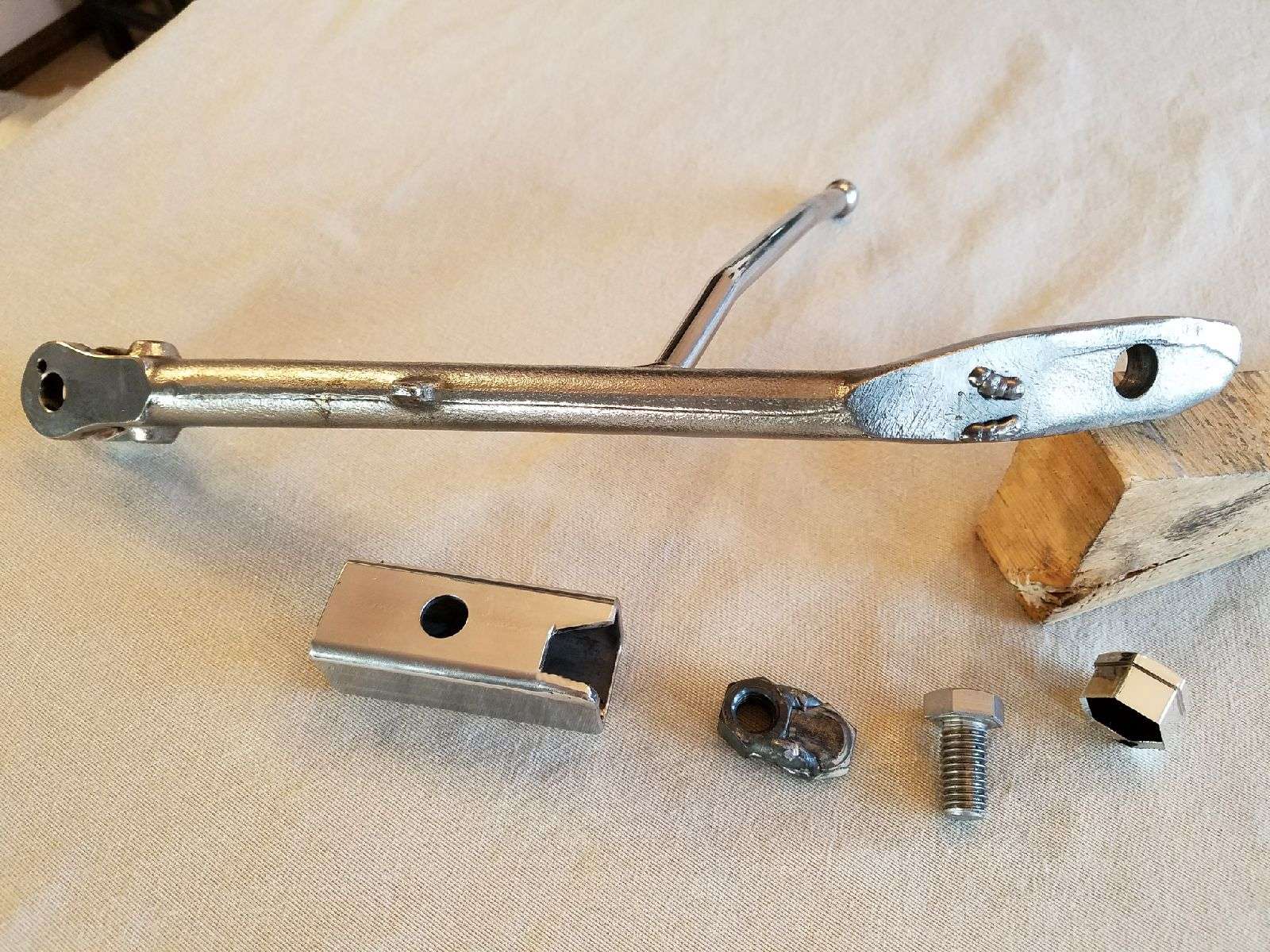

Posts: 5196
« Reply #12 on: September 22, 2020, 09:31:35 AM »
I came up with a solution to the lean a couple years ago.  It's not cheap at first because it needs a core exchange of the OEM sidestand.  But return yours and the core is refunded assuming it's not damaged.  I call it "Bigfoot".  The sidestand is cleaned and clear powder coated.  The Bigfoot supports a choice of 2 height increases, easily changed.  Lightweight enough that the OEM spring carries the weight with no problem.  I have one ready to ship. http://www.valkyrieforum.com/bbs/index.php/topic,100297.0.html
Here it is installed on my Jade:
