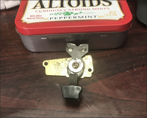

I was working on the turn signal switch.  It's not functioning well, works sometimes, other times not.  I disassembled and cleaned it.  It worked better but not consistently.  I figured I'd check for a new or used one.  Then I learned you don't buy the switch, you buy the entire housing.  I decided I don't care all that much about having turn signals.  I'll continue working with it and see what happens.
That leaves the front stop light switch.  I found a bunch of them for a few bucks each.  If I find mine is bad I can just replace it without having to buy the entire right housing.
did you take apart the thingies in the photo below? Just pluck them out of their slot. They're under the thumb lever. The thumb lever plate.
I took out and disassembled the thumb lever, lifted the switch out of its place and sprayed it with contact cleaner then reassembled it.  If it doesn't improve with use I'll take it apart again and have a look at the contacts you showed.  It looked like someone had been in there before because there was a very heavy, viscous grease which was causing more trouble than good.
Thanks for your post and pictures, those'll help.
« Reply #237 on: March 29, 2021, 09:35:12 PM »
You need to regrease it after cleaning it. The old Honda grease gets pretty hard and waxy. But you need some new grease.
