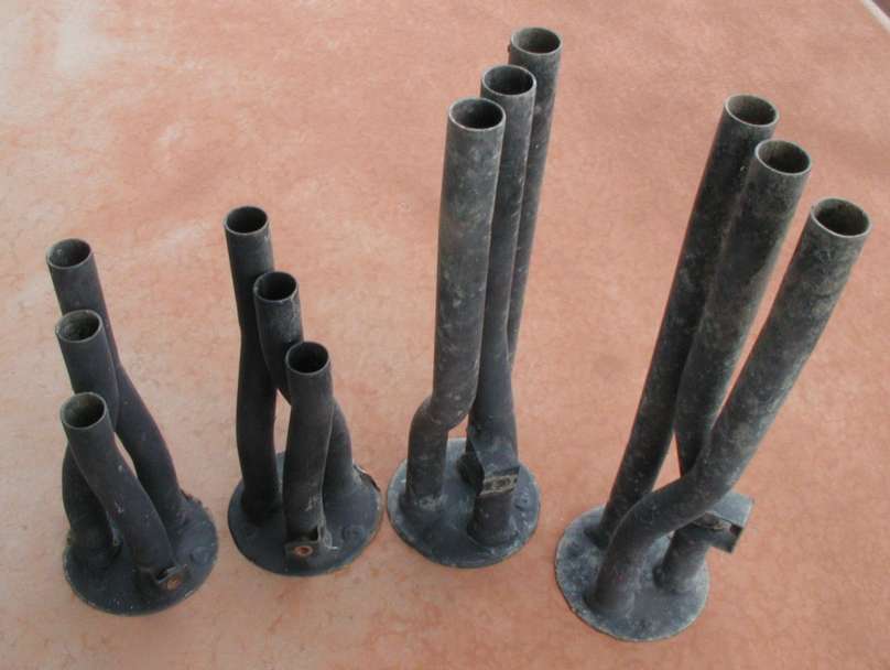

I just purchased a 2003 Valkyrie and the piglettes have been cut off.  On a stock exhaust how long should the piglettes be?
Posts: 16804
« Reply #1 on: January 26, 2015, 01:36:18 PM »
Tourer/STD on the left, Interstate on the right
You can get the above "piggy plates" here: www.horseapple.com/
Some times people cut off the piggies and then jamb a big drill
down in there and drill out more stuff, you might look down in there
with a light, or feel around with a stick...

Posts: 16804
« Reply #4 on: January 27, 2015, 04:46:56 AM »
I like quiet. If you want the quietest, find a set of unmolested Interstate pipes.
A full face helmet and drilled chopped pipes leads to unbearable droning
I think.
You may end up in good shape with piggy plates and plugs or something for
the drill holes, especially if you can get BigBF to help with the work...

Posts: 5196
« Reply #9 on: January 28, 2015, 10:18:20 AM »
The holes in the back baffles make it somewhat louder but not a lot.  More of the drone comes from the piggies being cut off.  Honda extended the outlets of the exhausts to the end of the tips to prevent drone inside the cone. You can replace the cut off piggies with the "piggy plates" pictured above - that's my pic of the 2 styles - either type is $20 for the pair plus $12 priority mail. You might want the longer ones (interstate) to move the sound to the back of the stacks if they are 36". Here's how Hedgehog installed the piggy plates w/o welding equipment:  http://www.valkyrieforum.com/bbs/index.php/topic,38448.0.html
You can't install the same baffle plugs that were drilled out because the ID of the piggies is smaller than the inner tubes where the baffles are.  I do repair them if they are drilled out and the back section is going to be used as silencers, as the OEM plugs can be inserted from the inside end and tack welded in place after the silencers have been removed from the cans and "skinned" so you can access the sides of the tubes.  There are holes on the sides of the tubes where weld can hold the baffle plugs in place.  They look like freeze plugs you see on the sides of a cast iron auto engine block.  I have a ton of them on hand from the early days, when I removed the entire baffle assembly intact - now I cut the baffle plugs out of the tubes and re-use them.  So your holes can't be repaired the conventional way unless you cut the back section off - it's 7 3/8" from the end face - just fwd of the rear most spot welds on the sides of the muffler can. Then skin the silencers - I use a lathe - and then the plugs can be welded in. Yes I can do that but if you are going to that trouble of sending me your pipes, I'd suggest having the glasspack mod done to pick up some power - then you can insert the silencers back into the stacks when you want quiet and still have a deep rumbly note and more performance.  And have your custom look too with your stacks.  Send me your stacks (as well as your exhaust) if you already have them and I will do the mods and put it together, and discount the package.
