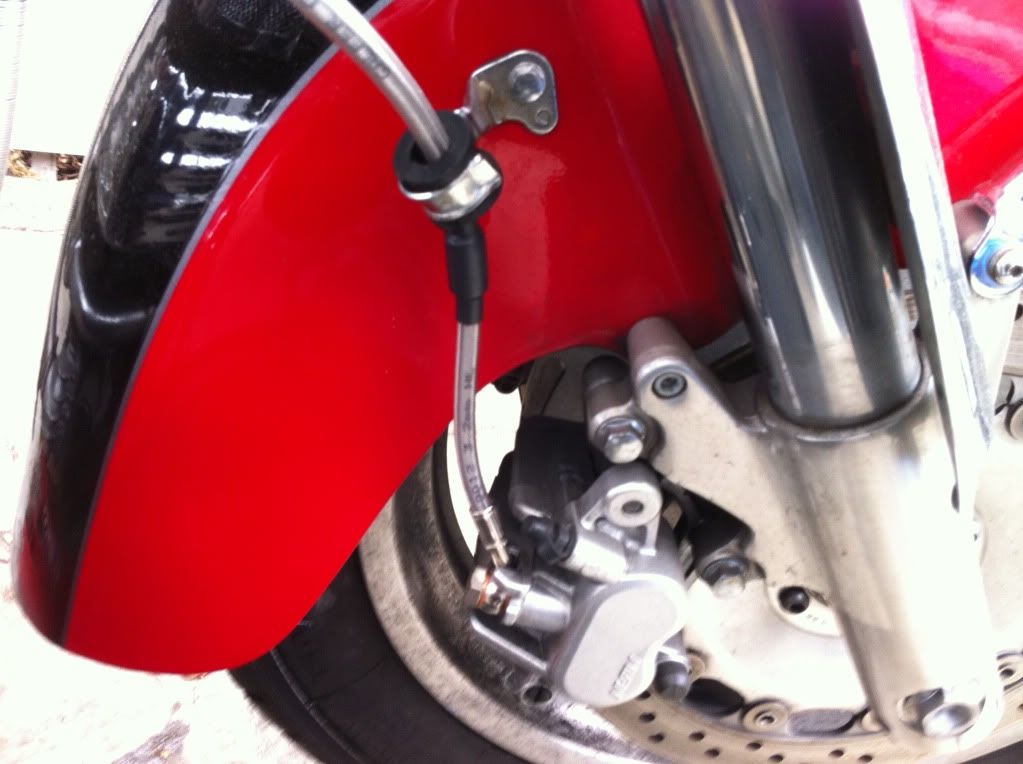

« Reply #251 on: March 02, 2013, 05:52:13 PM »

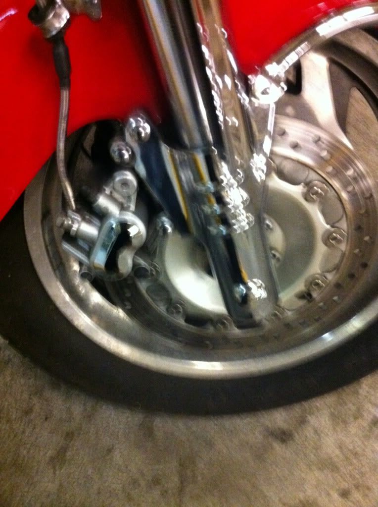

On your Galfer brake lines, I noticed you mentioned the lines don't fit in the front fender brackets tightly.  In your pics you show the supplied rubber sleeve below the brackets, those sleeves are moveable. Just slide them up to where  you need them, then put your other piece over them and you'll have a nice tight fit.
VRCC # 32473
01 Valk Std.
02 BMW k1200LTE
fordmano
Posts: 1457
San Jose, CA.
« Reply #252 on: March 03, 2013, 01:15:27 AM »
Really? WOW I never even thought about the possibility of them moving.
Thanks a bunch, I am at work so I will run out to the parking garage and check....

« Reply #254 on: March 03, 2013, 02:29:13 AM »
WELL I'll be cursed! Embarrassed
Olddog was absolutely correct, those little rubber deals on the Galfer brake lines do actually slide. cooldude
Here is the little black rubber line cover he was refering too.
The one actually attached to the cable and not the larger diameter one that was the stock one in the brake line holder.
Sorry the picture is blurry, but I think you can see the little Galfer rubber line cover (that actually slides up and down on the Galfer brake line) and the stock rubber line cover a little more defined in this picture from the angle.
Thanks again Olddog. angel

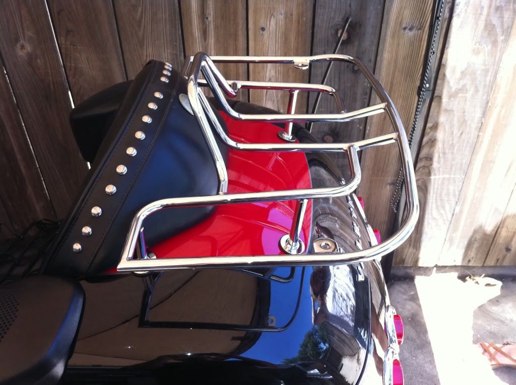

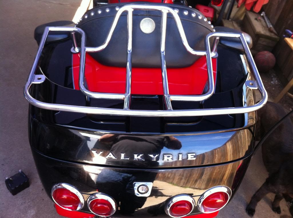

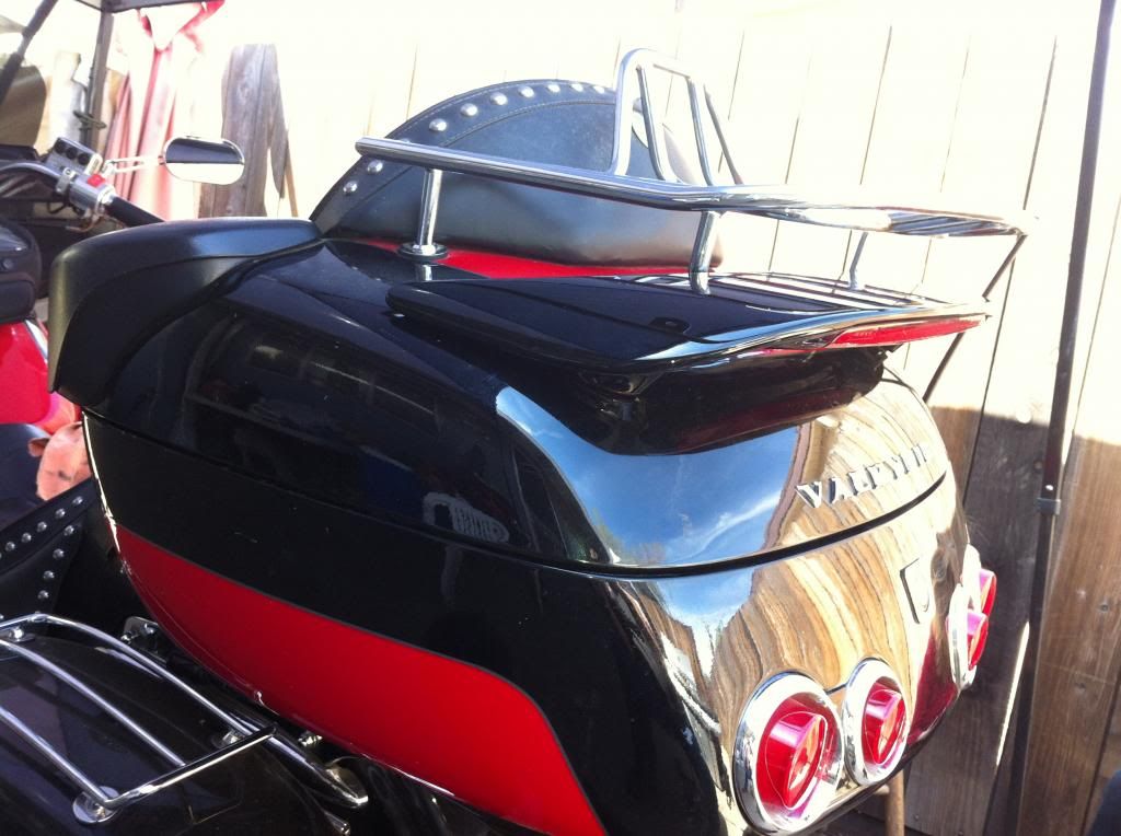

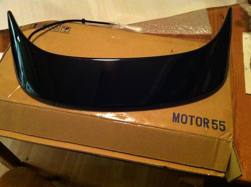

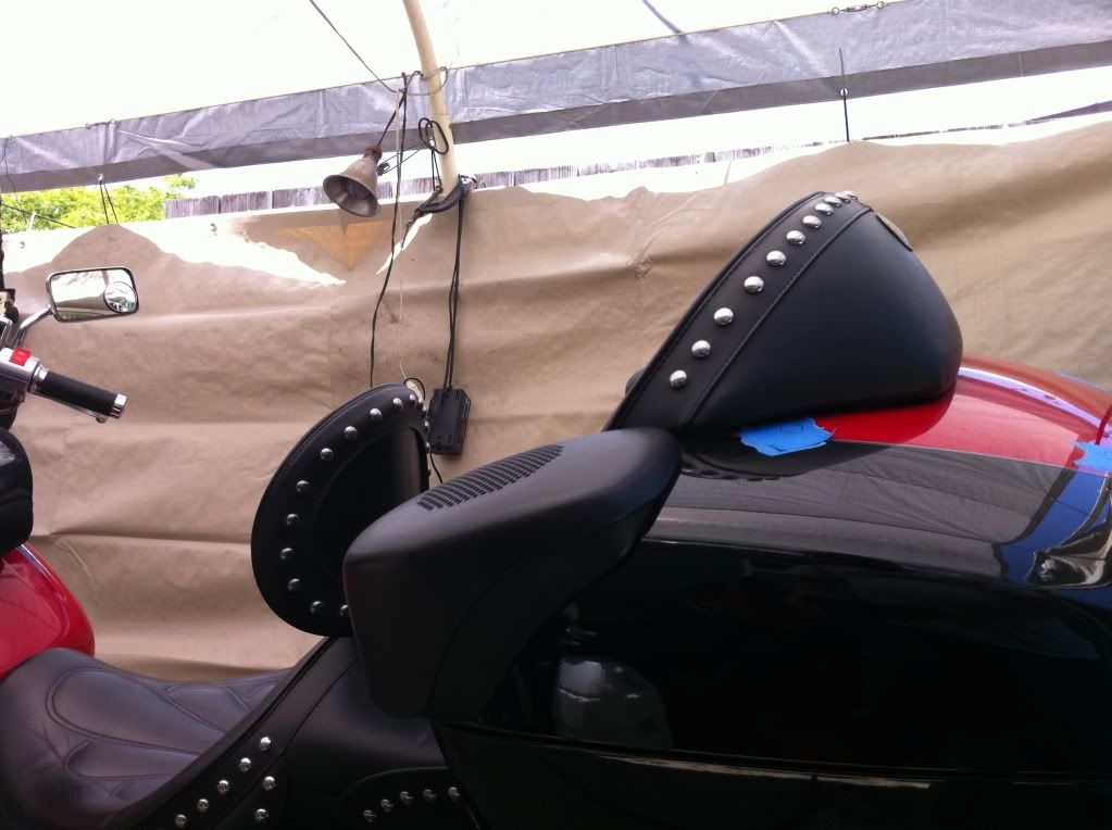

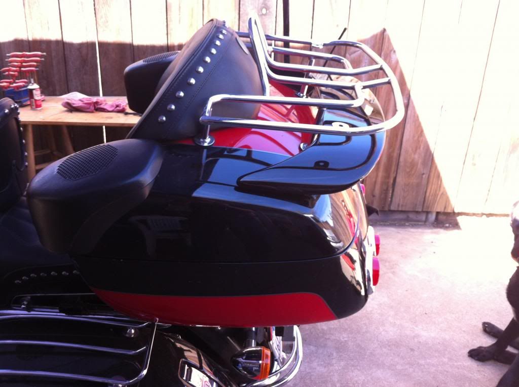

« Reply #257 on: March 24, 2013, 02:48:04 AM »
Ok I figured I would get back at this thread for a minute or so.

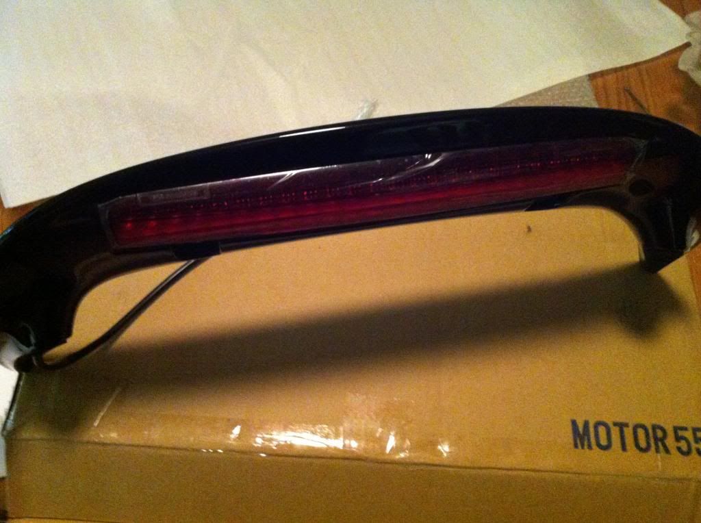

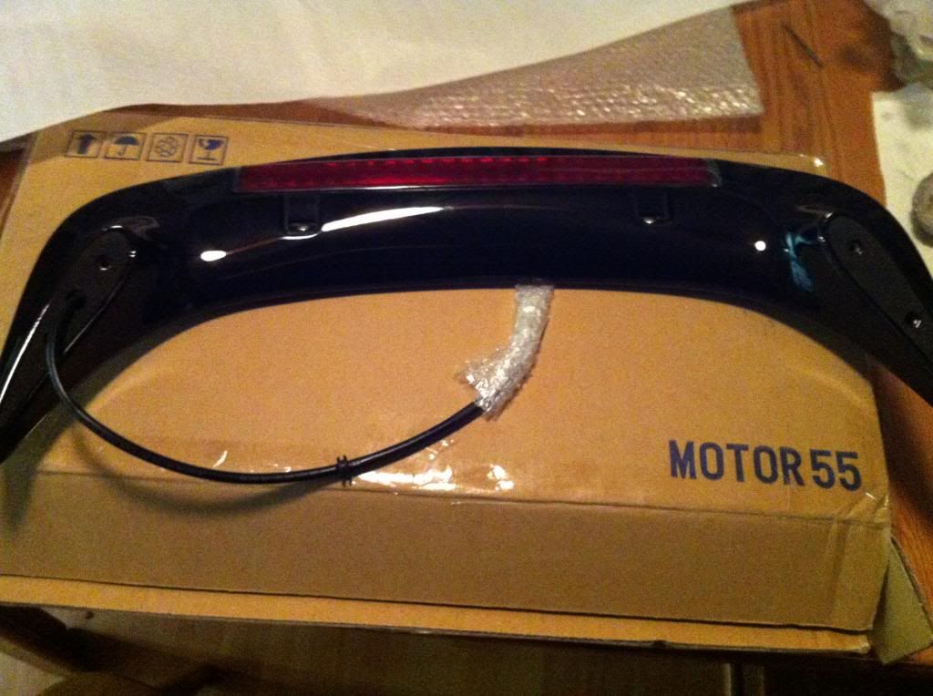

I have added a few tid bits. The best one lately was a gift from another member "MikeFoSho" Thanks Mike.
I spent a couple days working with Mike on His converted tourstate from Standard. We did the De-Smog added a belly tank changed over to a Pingel petcock, synched the carbs ad finished up some wiring for the I/S trunk he installed.
After a while to my surprise this showed up on my porch.
WOW! I guess he liked my work,,,, Thanks Mike.

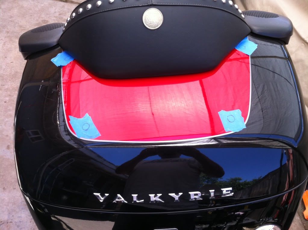

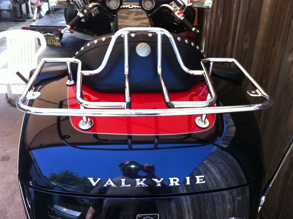

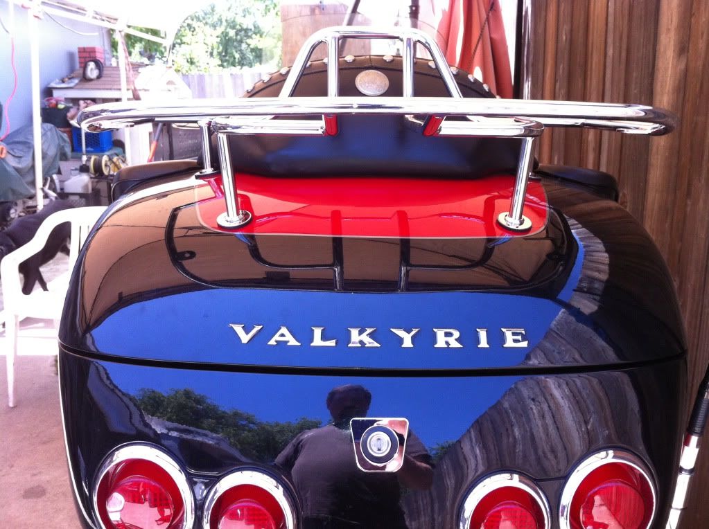

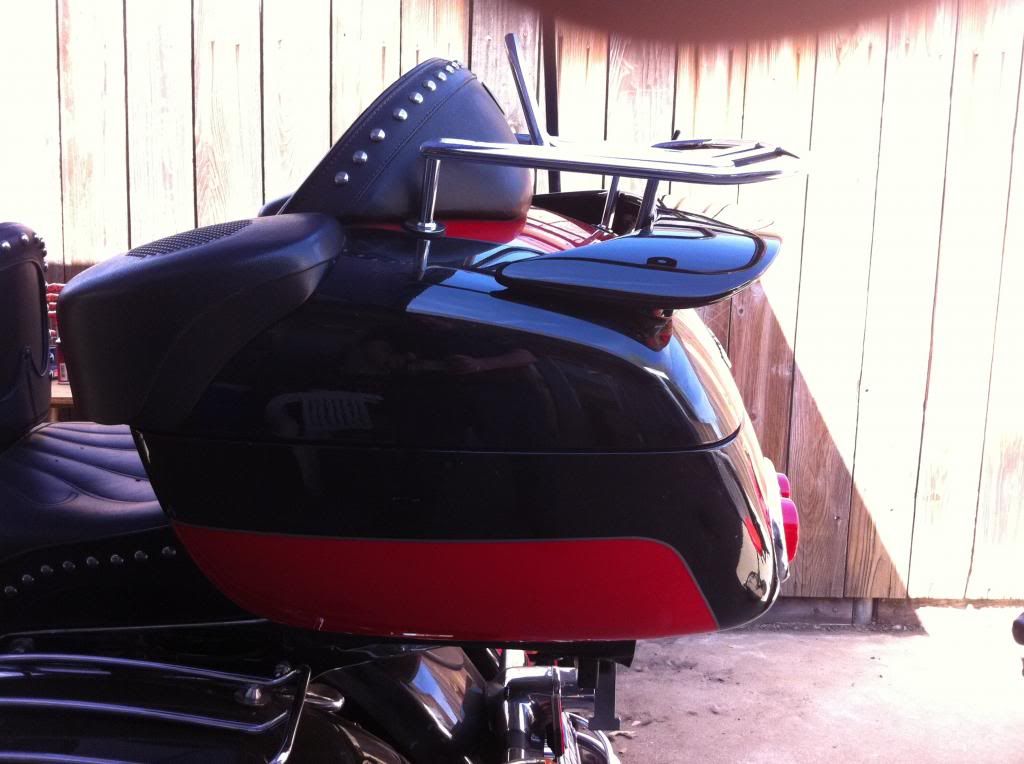

We had spoke about how much I liked the look of the rear spoiler and how much I liked the added 3rd brake light that it offers. well I guess he remembered our conversation.
So this weekend I finally installed it I was plenty worried about drilling more holes into my trunk lid and the possible consequences of a mistake. So with my wifes assistance I went for it and this is how it turned out.
Nice, I really like it, thanks again Mike.

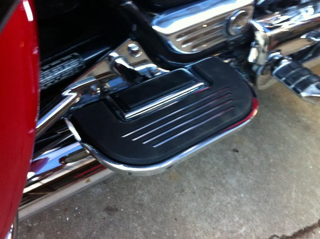

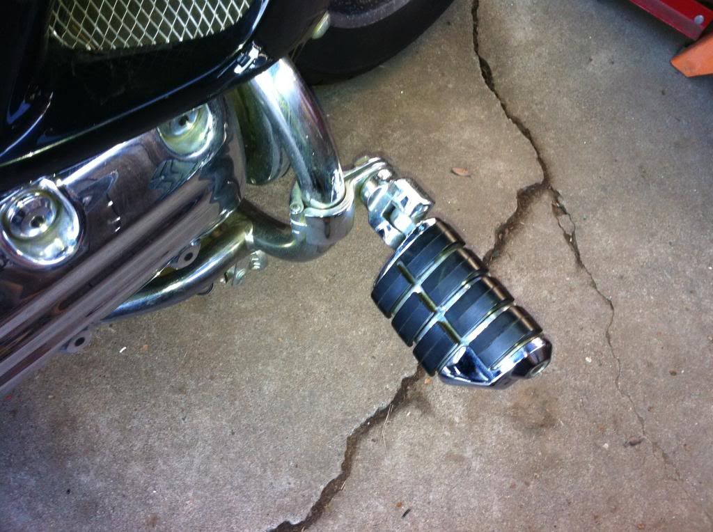

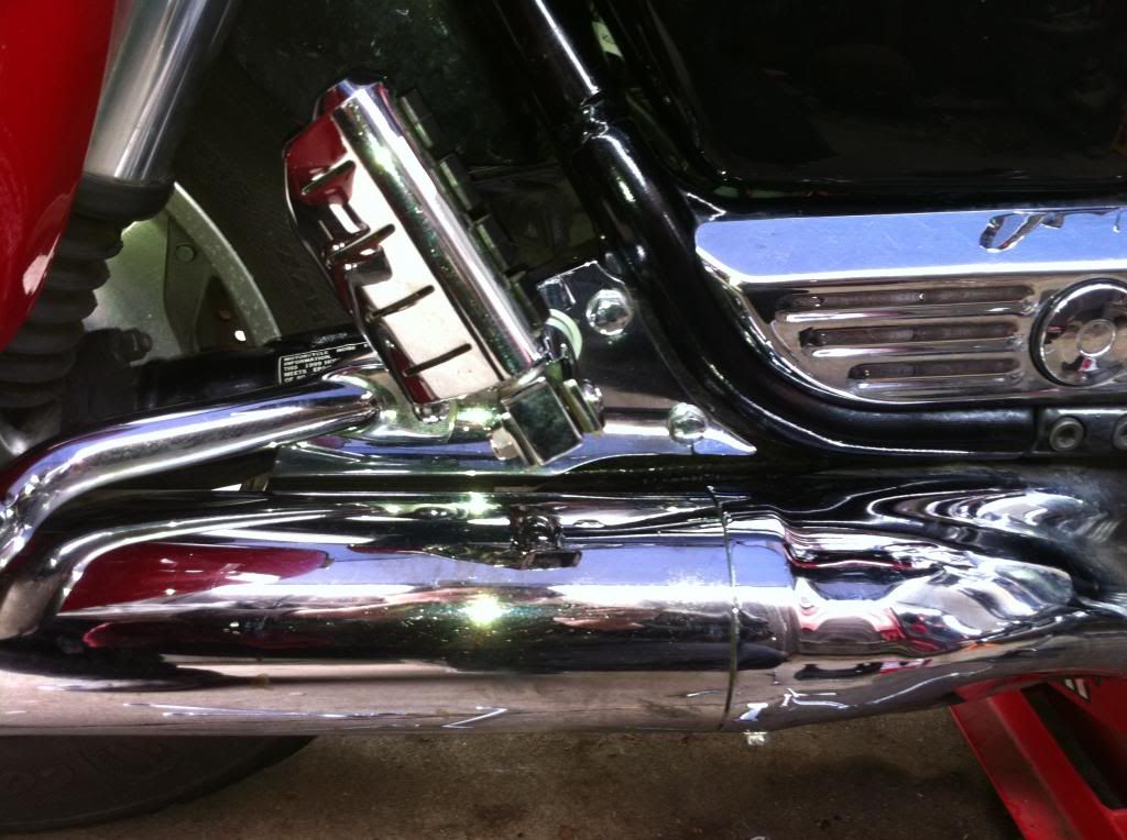

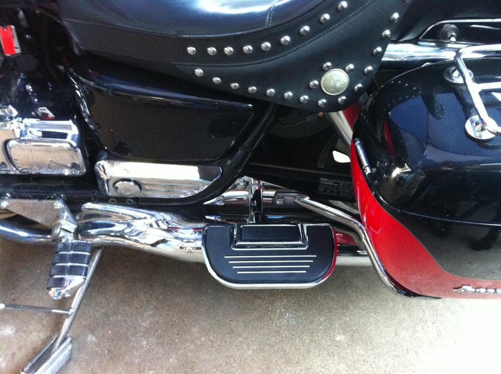

« Reply #258 on: March 24, 2013, 02:59:13 AM »

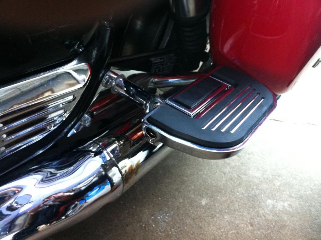

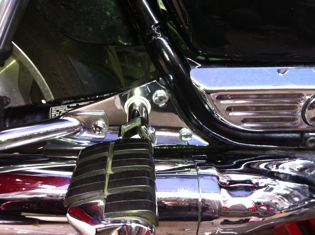

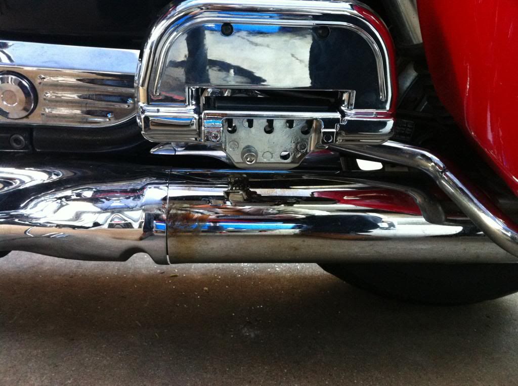

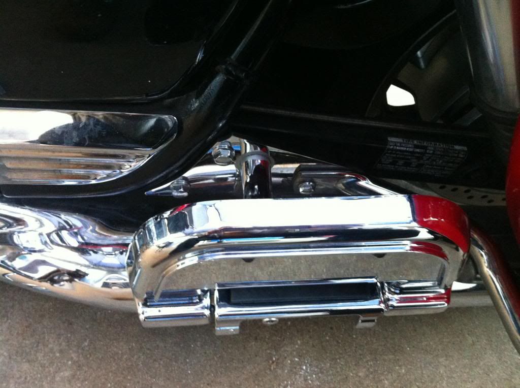

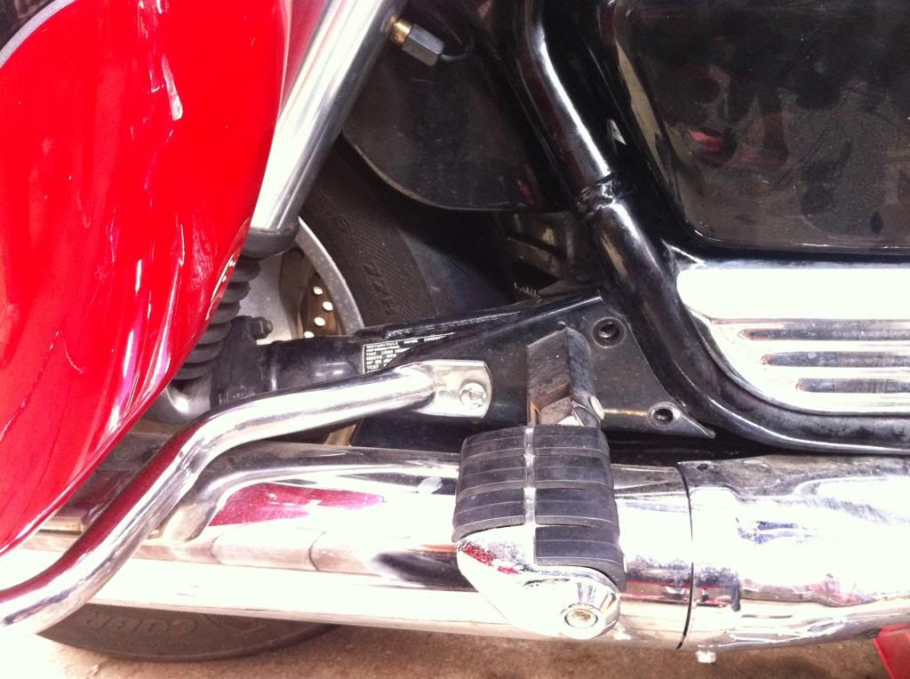

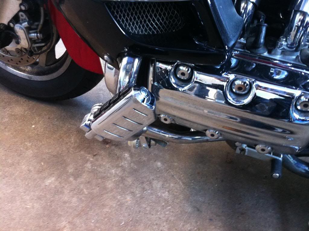

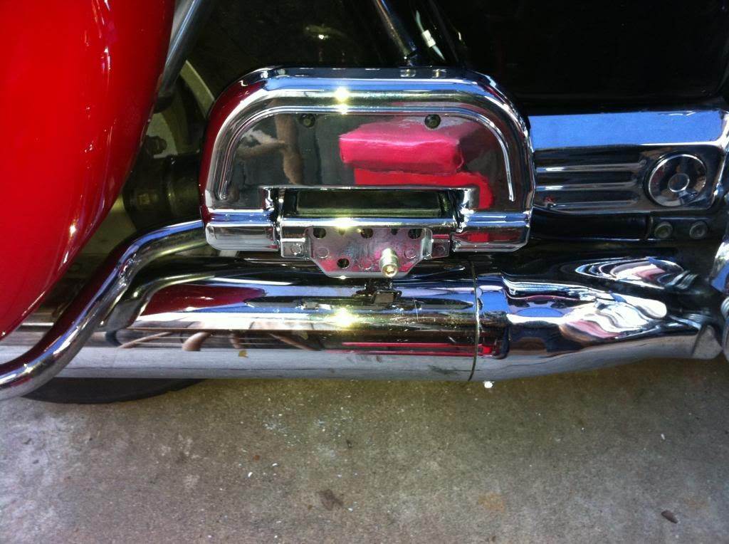

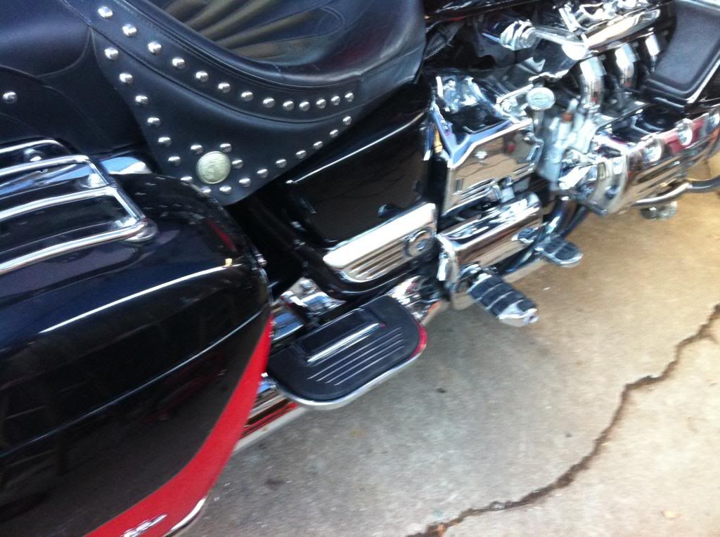

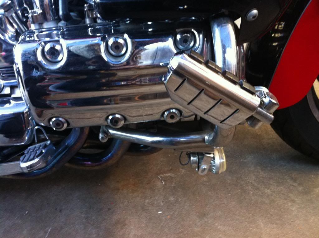

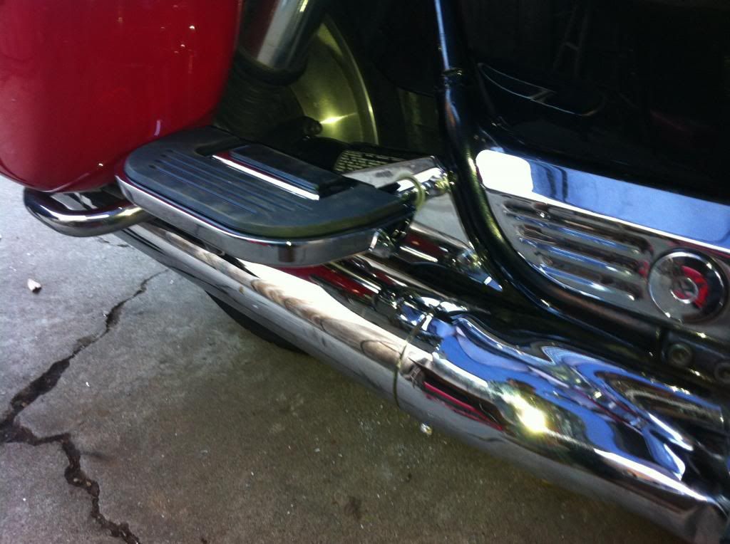

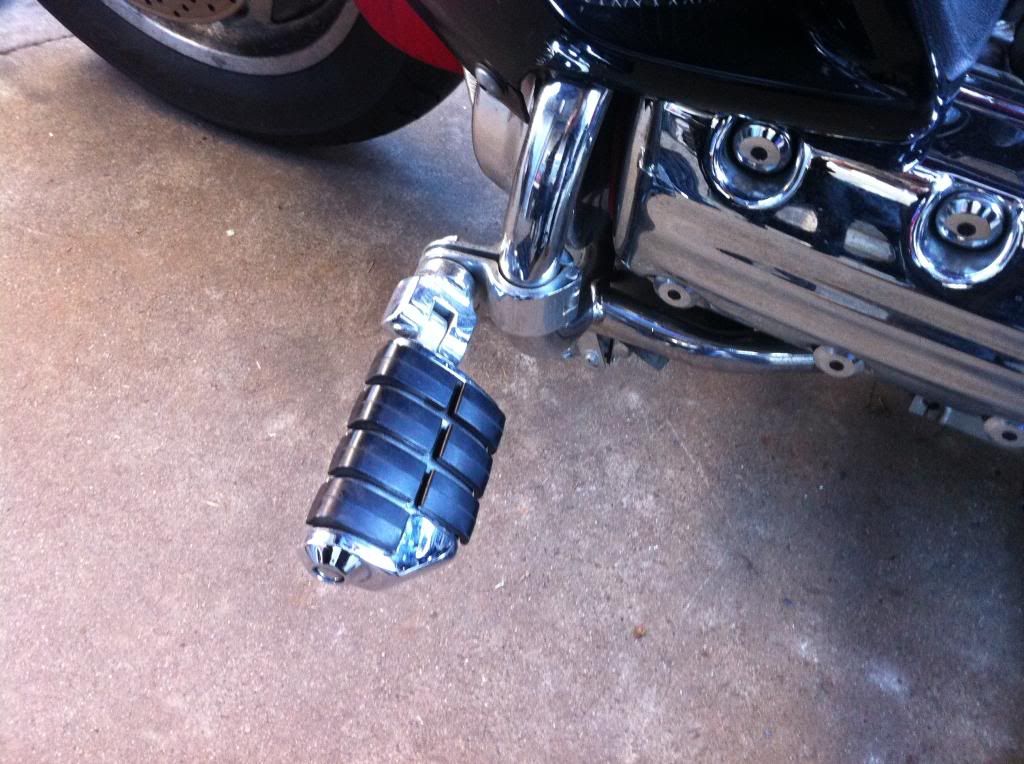

Now here a while back when this thread started I was in the planning of a road trip from the Bay Area (San Jose, CA.) to Las Vegas with some friends and this is one of the big pushes to get all these things done to my bike.
Well while we were on the trip my riding buddies and thier wives all suggested that my wife would be much more comfortable if I installed floor boards for her so I have recently finally gotten that upgrade done.... and added a a little more chrome in the process also.
I scored a set of newer nicer than what I had for Highway pegs and chrome rear peg mounts to replace my stock black mounts. and when the new floor boards came in I moved the newer page to the highway peg location and installed the wifes new floor boards...
Let me appologize for the poor quality pictures, not sure why but the camera was having a bad day with the lighting...

fordmano
Posts: 1457
San Jose, CA.
« Reply #259 on: March 24, 2013, 03:02:41 AM »
And yes the other side was done also........
